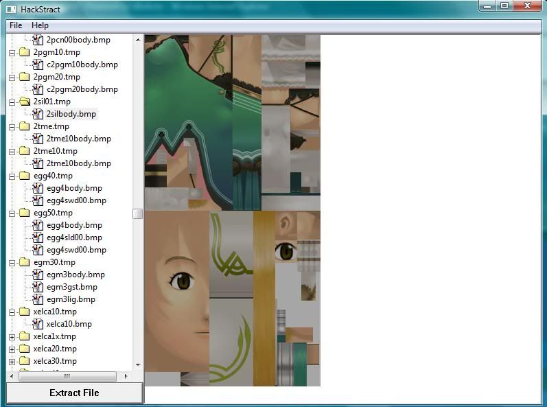

Also, I hope you all have Hackstract, because that's how you look up the textures that give you the file names for characters... (Look up the texture of a character you want to use, then look at the name of the folder its in, that is the name you search for in PS2DIS)

Step 1: Find the model file.
In this case, we want someone who's already generic, so this is easy. Look in hackstract or any other program that can view what's in the DATA.CVM file, and look for Kaochin's model skin. Long story short, it's in 2pcfz4 (the z's mark unique Chaotic PK models, save Natsume who is just 2ntm02). Searching through the save dump, you should come across three instances of the model filename:
1. 004CB1F8
2. 0092E588
3. 00B374D4 (Ignore this last one, I don't know what the game needs it for)
Either of the first two will do for our search.

To FIND what data belongs to Kaochin, we have to find her. To do that we open Hackstract, and tell it to open the DATA.CVM file, which is on the GU3 Disc. It will search for all of the textures in the game and list them.
To find Kaochin's texture, which will lead us to her data in PS2DIS, we have to first know what Kaochin looks like... (Why would you want to use her if you didn't know what she looked like?)
She has Orange hair, Purple dress, and a squiggly 'S' mark on her forehead.
(To save trouble, her file should be in the folder labeled "2pcfz4" which is what we will look for in PS2DIS)

Edit: Okay, so it takes awhile, but I'm figuing things out. So let's say I wanted to use Atoli's sprite (I actually just stumbled across it, I wasn't looking for her specifically). I look through Hackstract and find this
So I get 2sil01, which I type into ps2dis and get this
Am I on the right track or am I barking completely up the wrong tree?

Actually that's wrong... I have no idea WHAT 2sil01 is... why it is there... or what purpose it serves...
I think you had the right process, but it should only work for SPC and PC... what you have is a Monster/NPC entry, which is different and I haven't touched...
try the same for 2atl01 (Atoli's REAL character model data)
EDIT: Also, the top window in PS2DIS will show what the actual ASCII letters say, so if that is supposed to say "2sil01" it will be highlighted in the top window.

Satoh beat me to the hacking part, so I'll just say who that is.
That's shadow Atoli from the shattered Moon Tree meeting room in Reminisce. She looks almost Doppelganger-ish, so she is pretty cool at first, but if she gets hit in battle, that effect is lost and you can see her until you leave the area. Her palette is Atoli's, slightly darkened, but not to the level of an Anti-Existence/Doppel.
