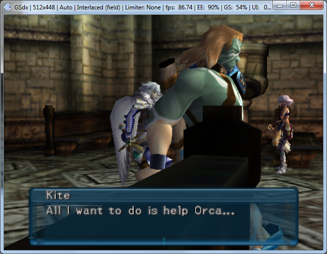

And with the newest official release, I seem to be able to run Infection somewhat, albeit very slow and the computer heats up like an oven, but otherwise, I should be able to get a few savestates off. Now if I can find a way to view the video memory from savestates...

The newest official release of PCSX2 is probably what you have already, but the one I used for all my testing (before now I mean) was 0.9.6 or unofficial 1.2.4a... Neither of which ran very well at all.
I think what I have now is 0.9.8?

EDIT2: I DID IT! With all things working against me, I did it! I managed to open the RAM data from a savestate and look at what textures were loaded, sure enough, while the palettes were absent, the font textures I was missing were in there! Not just English ones either; There's 4 files of nothing but Japanese characters. Two different sizes of kana, and two sizes of kanji.
All of the necessary files for retranslating the game to japanese are on the disc somewhere, and I can confirm the audio files for parody mode are as well, or at the very least the ones for one of the cutscenes.
I've also discovered that a large number of the purportedly "empty" folders that Hackstract finds, contain PCM audio files. I've found the files for the gate hacking demo, data drain, and the Ryu book demos... still searching for sound effects, but now have new leads!
...come to think of it, a number of the files in the DATA directory are like the Data.bin, but don't contain archives, instead having raw file data... I should look into what they might contain. Well anyway, I've accomplished something... now my eyes hurt. I will rest for the day.
EDIT3:
Found sound effect data, ADPCM, 11025hz, 0xEB0 interleave, in SNDDATA.bin at the very top (after all of the IECS___ tags.
Also found the original font files I was looking for. They're actually in the SLUS itself! Now if I can find the map generation algorithm or model display code I'll be golden... Though with all of the stuff we know now... we could almost write a PC port of the games requiring nothing more than the PS2 disc to run it... but that's just a pipe dream of course.

It has been a Very long time since I've posted here, but I am one year older and one year wiser and have come back with some exciting finds!
When I was going through event instructions all of that time ago I was convinced that every instruction was only 4 bytes, and that was how it was developed, when I came back to it I saw that was not the case, but each instruction had variable length and that recording the events as I came across them was not very helpful as a whole, but to record the appropriate lengths and functions would be to any potential modder that wanted to make their own events.
In any case I revisited old sections that I thought I had finished and came up with some new and interesting results. Here are several pictures first of what I've achieved lately.
In addition to that, I've uncovered several beta objects. There were originally plans for a Trapped Box and Trapped Barrels, that would explode when attacked, before I said that this functionality was broken and would freeze the game when tried, but when I summoned the Actual object, it worked flawlessly rather than trying to put the functionality in another object or actor. Surprisingly the Trapped Barrels even have a reddish tint as if they're dynamite which I thought was a nice touch.
Many of the "??" that were in my previous attempts at figuring out events have been uncovered, as can be seen from the picture with Orca in the Hidden Forbidden Holy Ground events, due to finding how the game makes party members unavailable.
Seeing how the game puts itself together is interesting. It is Extremely moddable, any monster can be loaded on any field, you can place any NPC you like into a dungeon (granted you're willing to sacrifice whatever event may have originally been there in the first place) the "unbreakable chain" is actually quite malleable.
Image[/URL]
You can modify the Golden Goblin Tag into an actual test of skill that would pit Kite (or whoever you choose as main character) against any desired foe and upon defeat, regardless of the foe, you would receive a reward (that is also of your choosing.)
And now I have absolute proof of all Four games being mostly inside //Infection, before it was a theory based on file names but I have now been able to break the chain so that I can activate later game's events (and if I can ever figure out how to access the other serves, actually see how much of the events are included) upon will.
Image[/URL]
And now for the coup de grace... something I've been looking for since Day 1!
Image[/URL]
As you can see we can now summon Any of the Phases Anywhere, they were surprisingly a normal actor summon in an area that I thought was invalid until I saw that the Golden Goblins are summoned onto the field by a 0B command rather than a 0C and that they were a higher value than I thought was valid as well.
Here is the information regarding my most recent findings.

EDIT: I thought this would be a neat picture, it''s not very practical to see in-game (it just so happened when I replaced the Expansive Haunted Sea of Sand for Hidden Forbidden Holy Ground I was tossed somewhere in the nether but eventually found my way back into the sphere that is the map Hulle Granz. They definitely put a lot of effort into a place that the player can hardly see any more than 10% of. The entire place is on level ground so while it looks like there's a deep ravine underneath, it's harmless to walk across, the back of the cathedral is open and empty though, they never included a back wall for fairly obvious reasons and the way collision works is that whenever you happen to travel into an area that would normally have collision you can't get back out of bounds.

Solo Skeith in a field with Wiseman Oh you sick puppy, you. Can you explain more about monster spawning!? I wanna see what happens by including multiple phases. Also is it possible to increase the main character's party limit? How about through portal use? Overall very nice.

Glad the pictures amused you, hehe.
The Monster Spawning is through events, it's replacing things that were already there with something else. It is done with a 0B command, 0B 00 XX 00 YY 0Y 00 ZZ 00 - XX is the NPC Bank, with 00, 01, and 02 being identical Party NPC's 03 and 04 being two kinds of NPC's, 05, 06 being seemingly identical monster banks, and 07 being the Phase bank, everything else freezes the game. YY is the Actor Number, which would differ depending on the accessed bank, ZZ is behavior which may have differing function depending on which bank is being accessed.

I've not tried to spawn multiple phases into a map yet, it is a solid theory, but until its tested it's difficult to say, but I can confirm that the Auto Lock-on Camera is phase specific, not map specific, because of that fighting phases like Fidchell and Innis in a dungeon could get a little glitchy. There is also an additional problem with fighting phases aside from Skeith in //Infection, the game doesn't have the cutscene data to call for the other phases' attacks, you can fight Fidchell and Skeith (or until Fidchell decides to use Data Drain rather than a prophecy) until victory, but even then the game expects an event to play after a phase is defeated so the game softlocks, it is likely an event matter of "Once this monster is defeated, play X event" or some such, as such unless it is connected to the event's completion it is preferred to be left as is.
What is interesting are cutscene calls in the phase actors themselves, meaning in theory that these can be changed to a valid option (Say Innis used one of its Doll attacks, you could replace it for Skeith's Data Drain as a placeholder (or the placeholder cutscene as a placeholder) the hard part would be locating these cutscene calls though.
Though it is strange, I've found all of the phases except for Morganna/Corbenik, I know that by textures extracted that the final phase of Corbenik is at least programmed into //Infection but it's not able to be called by the normal methods.

Well, here's a surprise... turns out battle works fine in Towns, but the problem is you can't summon monsters and trying to summon a magic portal breaks the game. What enemy type does work in towns surprisingly are Phases.
Damage works fine, attacks work fine, what doesn't appear to work fine are the Phases non-cutscene special attacks like Judgement, on concluding the attack the system will crash. But as you can see I was taking damage just fine and I was dealing damage to Skeith in moderation even though we were in a town.
